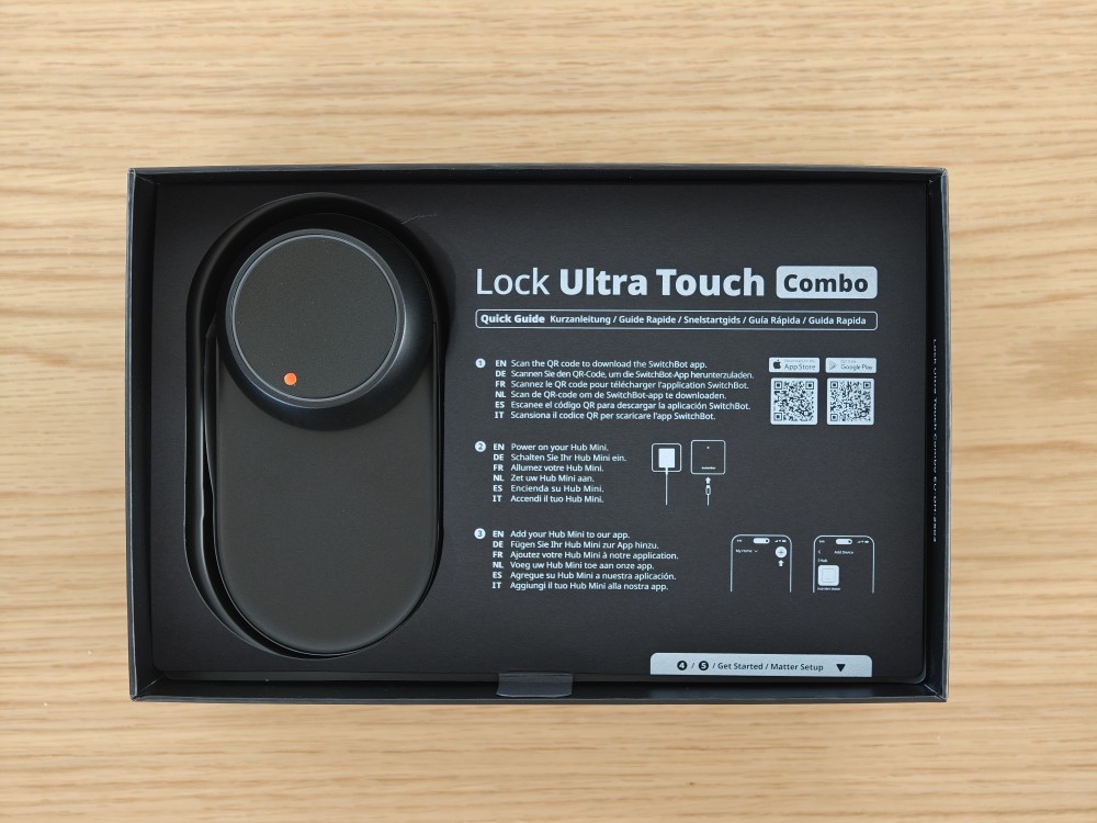

The Quick Guide puts you on the right path by letting you know the first steps, but, as we’ll see later, it’s the SwitchBot app that is carefully designed to ensure you have a flawless experience setting up the product. Bonus points to the packaging designers for adding a cutout to the guide to put the spotlight on the Lock Ultra.

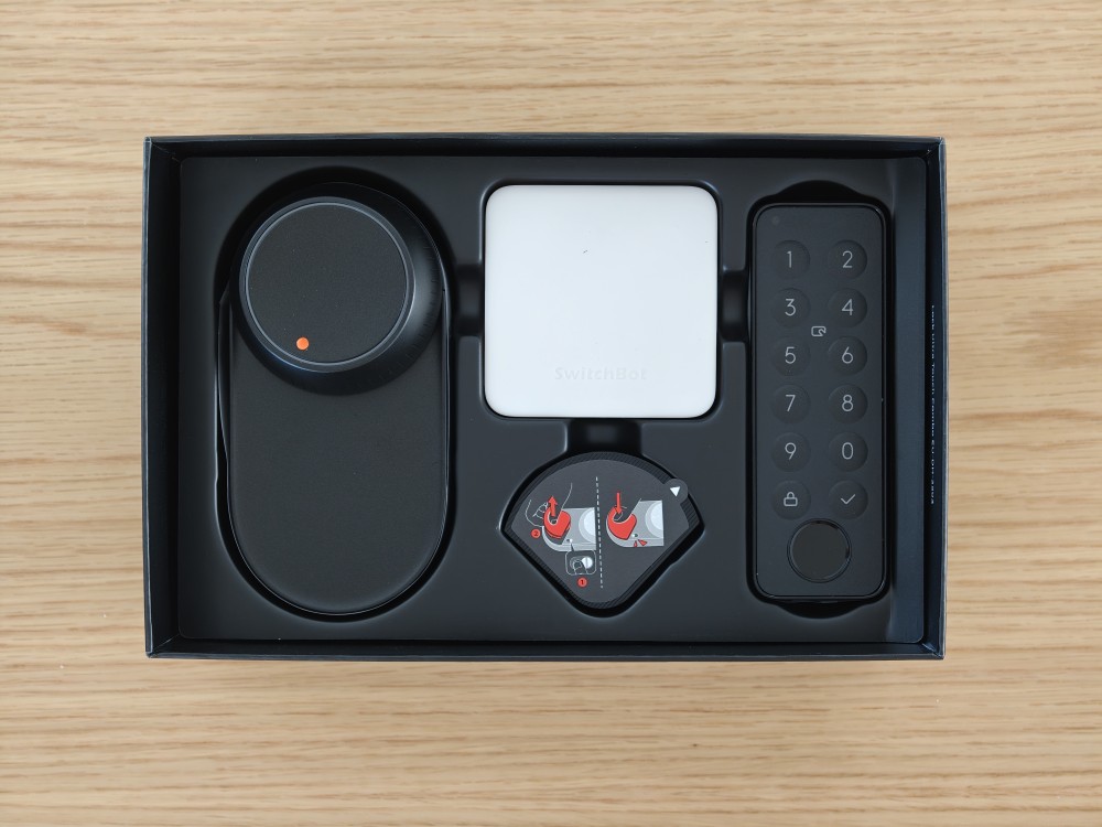

As you dive further in, you find the keypad, the Matter Hub and a neatly illustrated battery pack that, again, shows the attention to details and the team’s eagerness to ensure you have a smooth setup process.

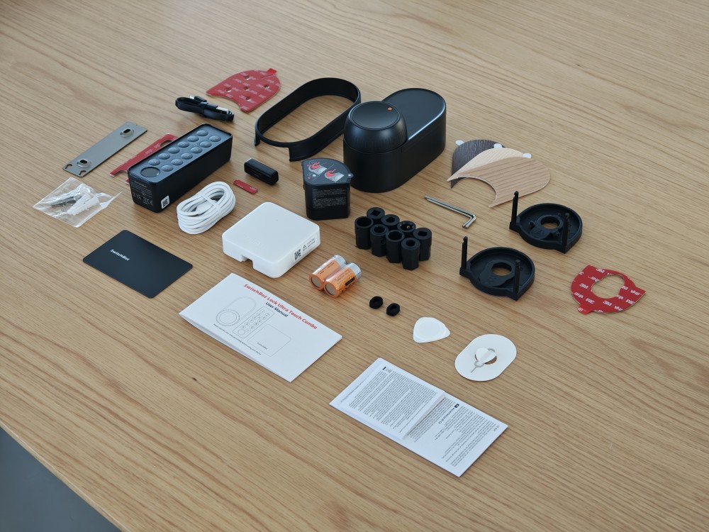

Still, despite the unboxing so far, I didn’t expect the SwitchBot Lock Ultra to pack so many accessories in the final layer of the packaging.
The product page has more information about it, but, in short, if you have a door, you can probably use the SwitchBot Lock Ultra. The packaging includes different adapters and installation methods to cover most cases. Even in cases where your door might need a special adapter, SwitchBot also provides those, either as a kit, or through support, with the 3D Printing service.

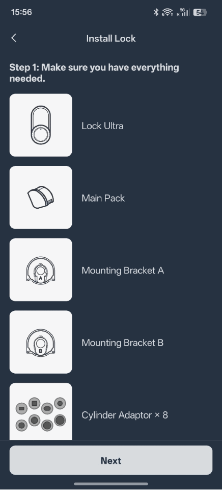

Instead of trying to make you follow some sort of “Choose Your Own Adventure” Instructions Booklet, the SwitchBot app holds your hand every step of the way. After you connect the app with the Lock Ultra (and install any missing firmware updates), the app shows you, step by step, what you need for your specific lock type, and how to do it. If you’re not sure on what to do with the images alone, they also provide video guides for the less straightforward steps.
To be completely honest, the step that took the longest wasn’t even related to the SwitchBot Lock Ultra, but to my lock. It took me more time to remove my lock’s escutcheon than it took me to install the smart lock. From start to finish, it didn’t take me more than 15 minutes to have the lock ready to use.

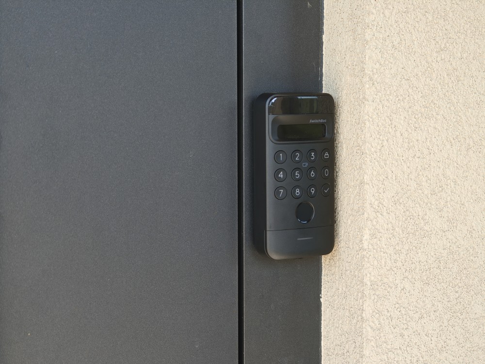

The Keypad Vision adds two key features over the Keypad Touch:
On top of that, it has a built-in speaker that gives you information as you unlock the door, and it has a button that doubles as a doorbell. Considering the price difference over the Keypad Touch, I think it’s worth the update if you’re willing to spend a little extra. The main reason is the face unlocking for those situations where you have bags on both hands.
There is a downside to this keypad, though. It requires a clearance of at least 6cm on its right side to be able to remove it from the wall mount (which has a tamper alarm, by the way).
Unfortunately, my door frame doesn’t have that much clearance, so if I ever need to remove the keypad, I will have to unglue it. But since it can be charged with a power bank, I think this is a minor gripe.

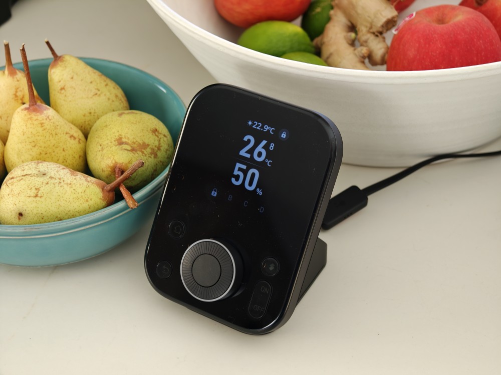

The other accessory I received was the SwitchBot Hub 3.
The SwitchBot Hub 3 brings a lot to the table, but whether it makes sense for you ultimately depends on your smart home setup (or whether you have one at all).
The Hub Mini Matter Enabled that comes with the Touch Combo gives you the same basic functionality at a fraction of the price. Matter support - a smart home standard that is becoming a true standard thanks to the backing of tech giants like Google and Apple -, Bluetooth, IR remote functionality, and, in a nutshell, the ability to connect your smart cloud to the cloud for remote control regardless of where you are.
But that’s where the similarities end. The SwitchBot Hub 3 adds temperature and humidity monitoring (and CO2 if you have a separate sensor), a display, and buttons to control your other SwitchBot, and streaming devices. It also acts as a hub for up to 30 Matter devices, and lets you control pre-set scenes.
This is the kind of product that you probably know if you need it, simply by going through the product page. If you’re not sure, you’re probably fine just getting the Hub Mini.
A sidenote here. I currently have no other Matter devices to further test this Hub, so I wasn’t able to truly see what the Hub 3 is capable of. Still, I will write a separate review once I get it connected to Home Assistant through Matter.

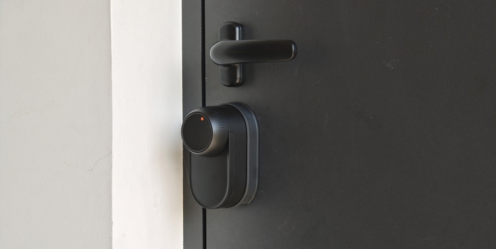

The first question in my mind when I’m considering a Smart Home product is “Does it make my life easier?” If not, what’s the point? In this field, the Lock Ultra has full marks. Once you have everything set up, you simply forget that this is a smart product. It just works, without a hassle.

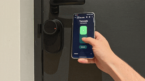

When you’re coming inside, you can open the door a number of ways - code, fingerprint, face, NFC, app or even Auto-Unlock, currently in Beta. You can also use your key, but I don’t see why you would.
From the inside, things are as easy. You can simply turn the Lock Ultra’s knob to lock and unlock the door. That knob also doubles as a Quick Key that does that for you. It’s so easy and intuitive that I regrettably had to disable the feature because my 2-year-old would keep locking and unlocking the door.
Another option is using the SwitchBot Hub 3 to unlock the door, the app, or even Home Assistant, as I’ll show you later in the review.
In short, the Lock Ultra adds to the Smart Home experience without getting in the way.
