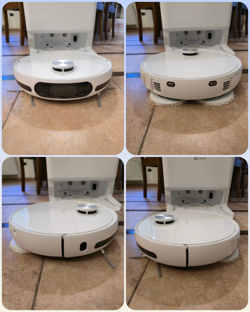

Robot dimensions: Diameter 365 mm, height 101 mm.

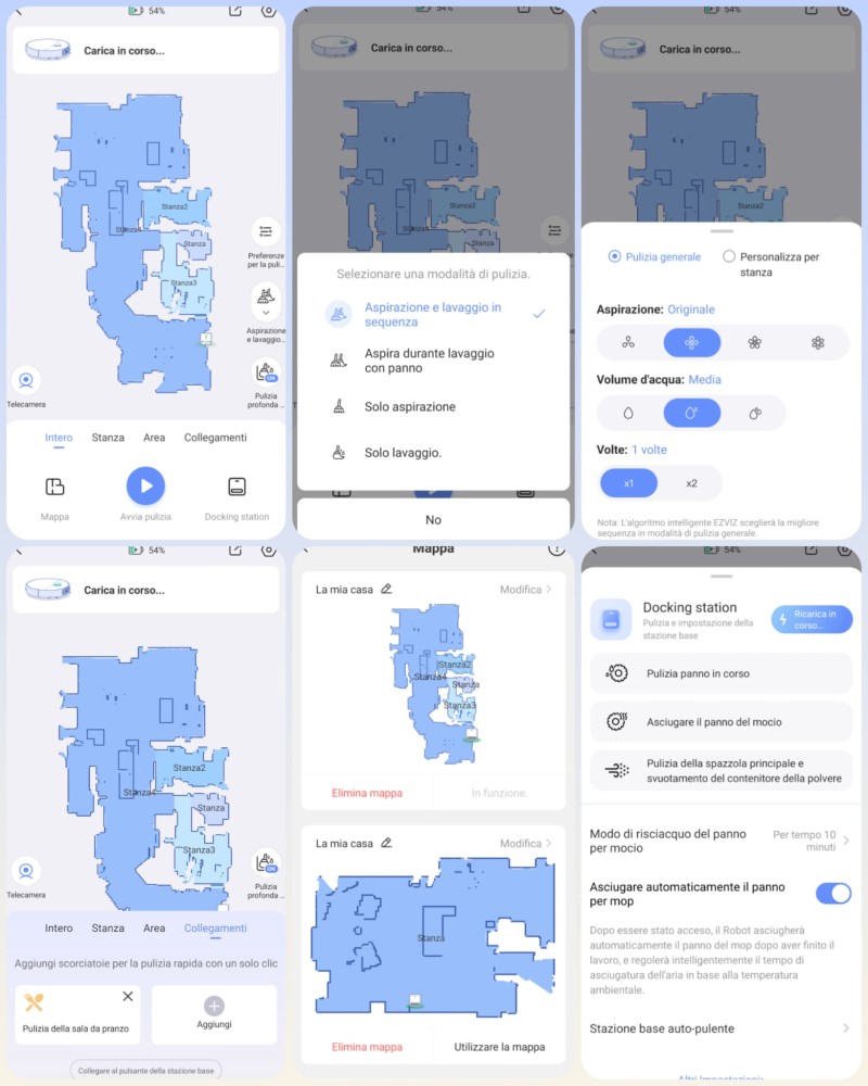

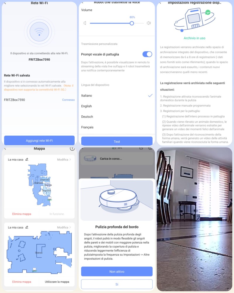

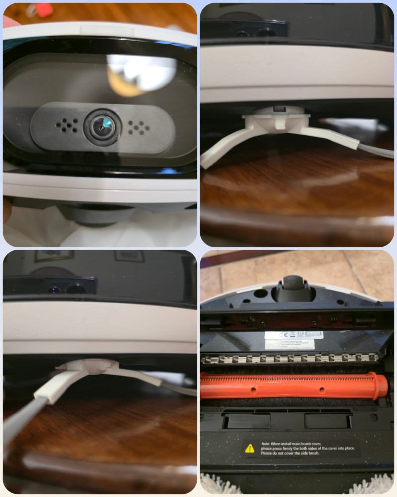

At first startup the robot begins mapping the rooms, combining LiDAR and camera. In an average 70/100 sqm apartment with ⅘ rooms it completes the map in a few minutes. The EZVIZ app is intuitive and allows you to divide rooms, set no-go zones, and choose different modes (vacuuming, washing, or both). Thanks to the camera, it recognizes, photographs, and avoids the most common obstacles in the house, including humans and pets, for which it can make short videos by activating the dedicated function.

On paper the 7200 Pa don’t impress: many competitors declare higher values. But in practice tests the RS20 Pro collects dust, crumbs, dog hair and hair well. The central brush with integrated comb makes the difference because the hair is vacuumed and at the same time “cut,” preventing tangling, resulting in less maintenance. The robot is slightly wider than average, so not ideal if you have chairs where it has to slalom, but lower than average so it slips under quite a few pieces of furniture. The side brushes are 2 which helps with cleaning, they don’t extend but lift during washing so they don’t get dirty.

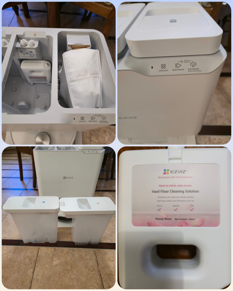

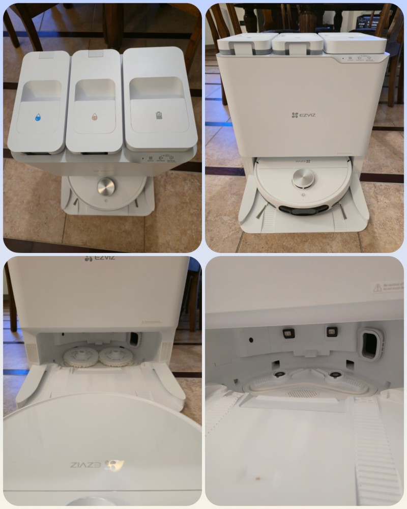

The heart of the system is the base. It’s really bulky (more than half a meter wide and tall), but it integrates everything and has larger-than-average tanks and bag: it empties the dust container, refills the water in the robot, washes the mops with hot water and dries them with hot air. The automatic detergent dosing is a neat touch that saves money and patience (for those who don’t have it). A special round of applause goes to EZVIZ for being one of the few brands not to have removed the convenient function buttons from the base.
Note to point out: the mop washing tray is not removable, so manual cleaning is not very convenient. However, EZVIZ includes a little brush and an automatic base washing function that helps keep everything tidy.
