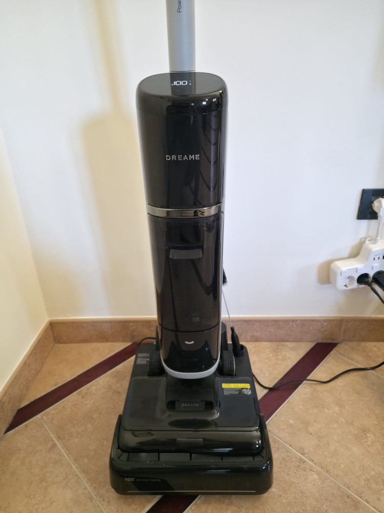

With the H15 Pro Heat, Dreame takes a decisive step toward a new generation of wet & dry floor washer vacuums. This is not a simple upgrade, but a product that introduces true hot-water floor cleaning, intelligent automation, and advanced hygiene and drying management, bringing everyday cleaning closer to near-professional standards.
It is designed for those who want to clean less often but better, with visibly superior results compared to previous models, reducing time, effort, and maintenance. As usual, below I list and explain the main technologies and functions.
ThermoRinse™: hot-water floor cleaning

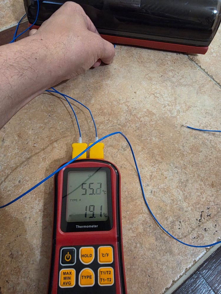

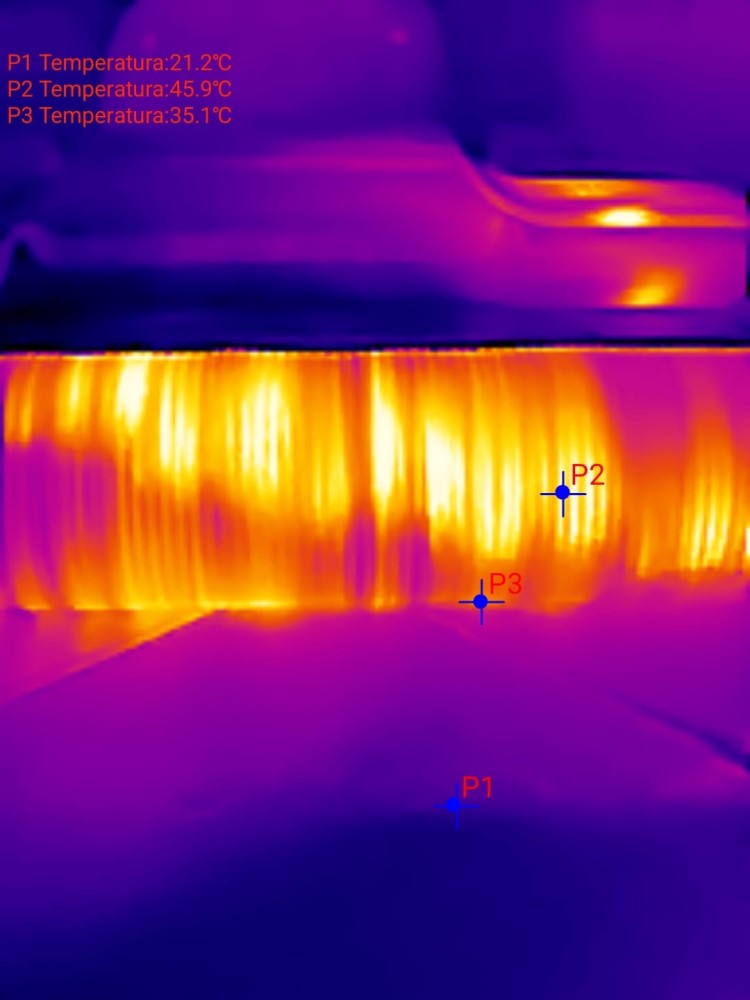

The heart of the H15 Pro Heat is ThermoRinse™ technology, which uses water heated directly by the floor washer, declared up to 85 °C. For accuracy, I specify that once the water is distributed onto the roller and the cold floor, it inevitably cools down, settling at around 55/56 °C. I measured the temperatures under the roller with a K-type probe for precise readings and the values on the body with a thermal camera to show which parts heat up and where the hot water is generated. This is not just “lukewarm water,” but a temperature sufficient to:
dissolve grease and stubborn dirt more easily
remove oily stains according to declared tests
remain gentle on parquet and sealed wooden surfaces
The result is a floor that is not only clean but also degreased, with better hygiene and fewer streaks. In testing, the perception of greater cleanliness is tangible.

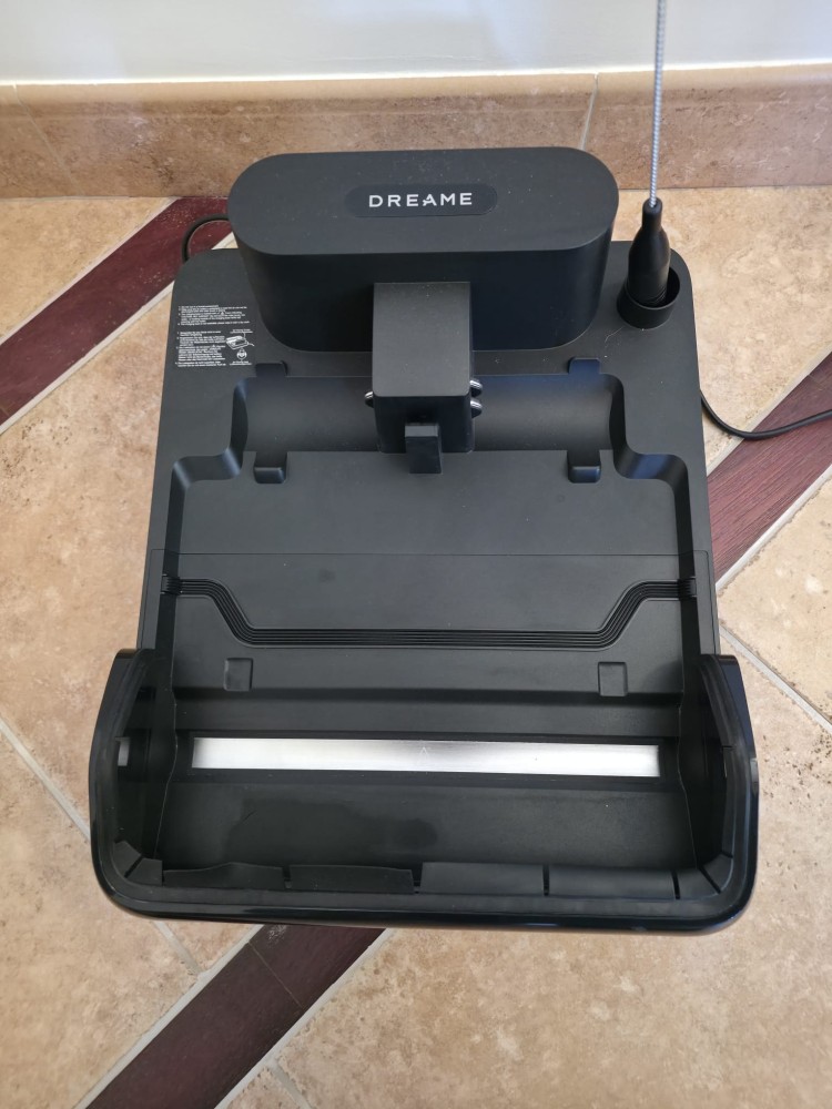

immersion washing of the brush at 100 °C (ThermoTub™)
eliminates up to 99.9% of bacteria and ensures complete cleaning of internal ducts, with less risk of buildup and bad odors
intelligent AI drying with humidity detection: the moisture level of the roller is constantly monitored to start, if enabled, additional drying—ideal even in very humid environments. Fast drying cycle: 5 minutes at 90 °C, or a quiet alternative: 30 minutes at 85 °C at just 63 dB.
The brush comes out sanitized, and ready for use, without odors or residue. not always perfectly dried but If it remains damp, the sensor, if activated, will start an additional drying cycle. It can be set to 3 detection levels with varying sensitivity.

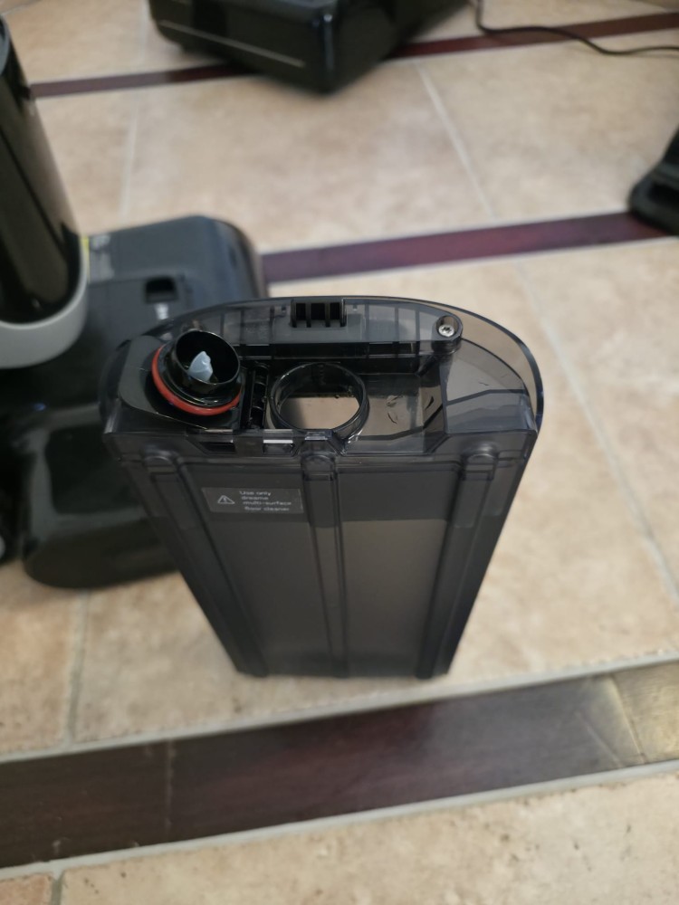

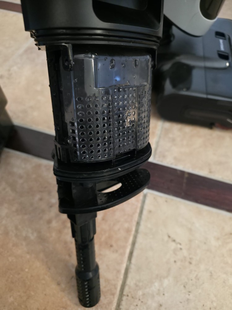

The full 180° tilt capability allows cleaning under low furniture, with a flat height of about 14 cm. Even in a fully horizontal position, it maintains effective suction, losing only some maximum dirty-water tank capacity, which drops from 650 ml to 400 ml when laid flat. It is naturally equipped with a liquid/solid separator.
The clean-water tank is 800 ml and lasts a long time in automatic mode thanks to smart water-volume regulation.
