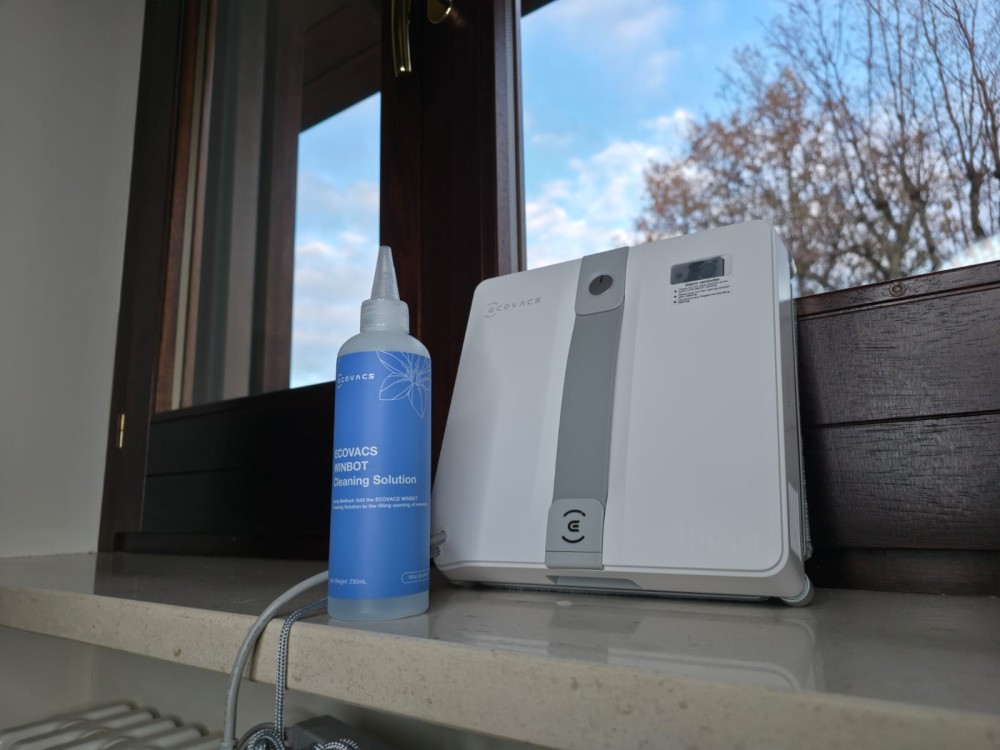

Design and technical features

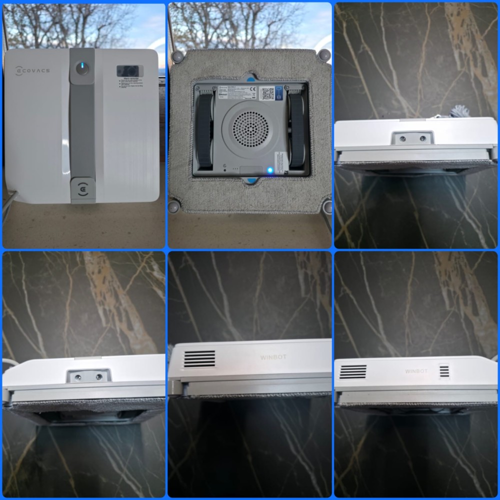

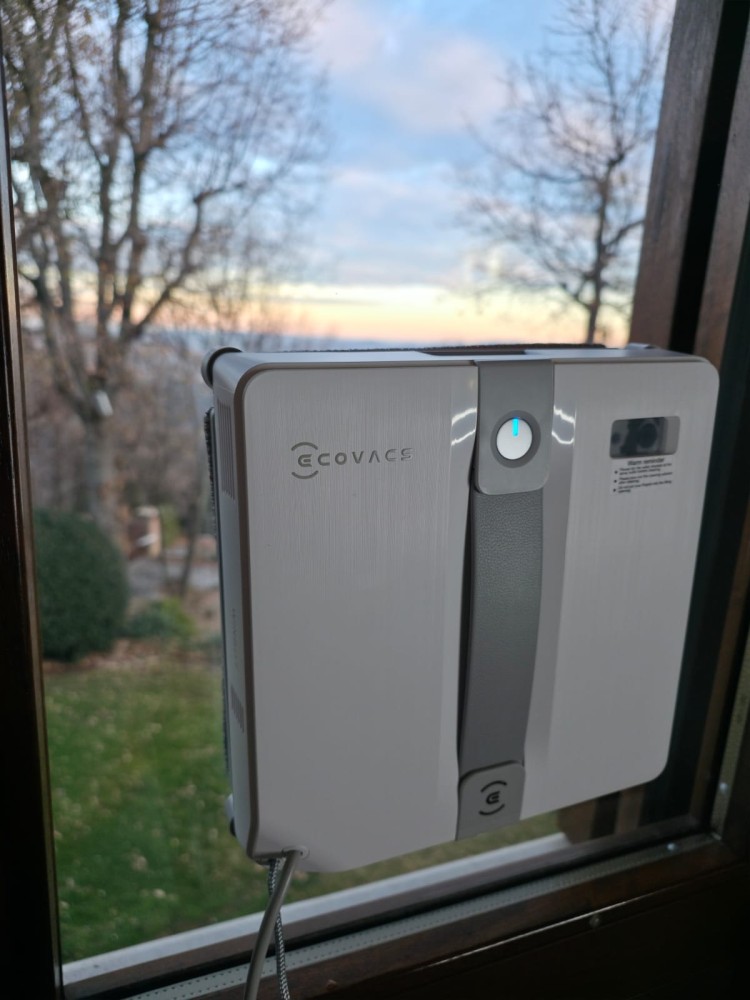

The WINBOT MINI is entirely made of quality plastic with solid construction, featuring a flat and squared design that allows access even to tight spaces. Its dimensions are 215 × 215 × 55 mm, with a weight of 1.3 kg, placing it among the most compact window-cleaning robots in its category.
The body is white and equipped with a soft faux-leather handle, useful for applying and removing the robot from the window in complete safety.

On the rear side there is a 3,200 Pa suction motor, which creates negative pressure between the robot and the glass, ensuring stable adhesion to the vertical surface.

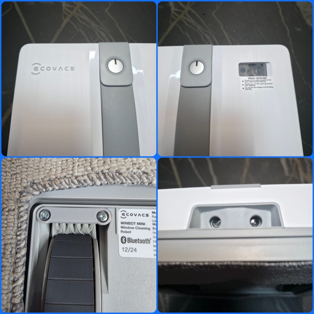

Movement is achieved through two rubber tracks, equipped with small integrated brushes that keep them clean during use, ensuring smooth and constant movement.
On the base we can also observe:
The dense microfiber cleaning cloth, although soft and effective, has a limited usable surface due to the large central opening required by the suction system.
At the corners there are four sensors with integrated rollers, essential for precise detection of window edges.

The WINBOT MINI integrates 4 spray nozzles (2 upper and 2 lower) with ultrasonic nebulization technology, capable of atomizing the detergent into 10-micron particles.

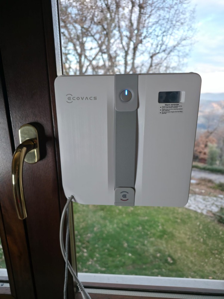

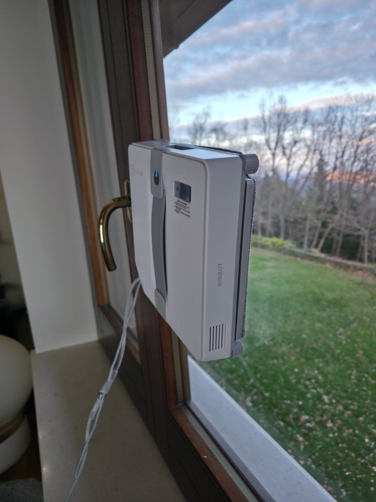

Adhesion is strong and stable, to the point that I also wanted to test it on frosted glass doors, bathroom ceramic walls, and kitchen backsplashes. The little one really sticks everywhere. These are not part of its normal use and would not make much sense, but it was a test to assess the level of safety and reliability. And safety also concerns the user side.

press the power button and place the WINBOT MINI on the glass, pressing the start button
The robot automatically anchors itself and starts cleaning.

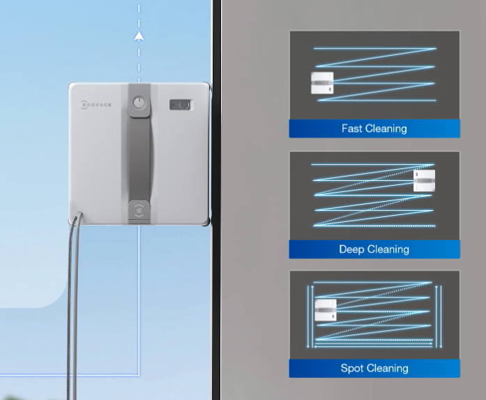

WIN-SLAM 3.0 technology allows planning the most efficient path by detecting window size and frame. Spray is managed automatically, and in the case of dirtier areas it can be controlled manually via the app, although it is preferable to start a deep cleaning cycle, which passes multiple times both horizontally and vertically and focuses more on the edges.

Available modes are:
quick cleaning
deep cleaning (with edges)
full cleaning (double pass)
manual control like a remote

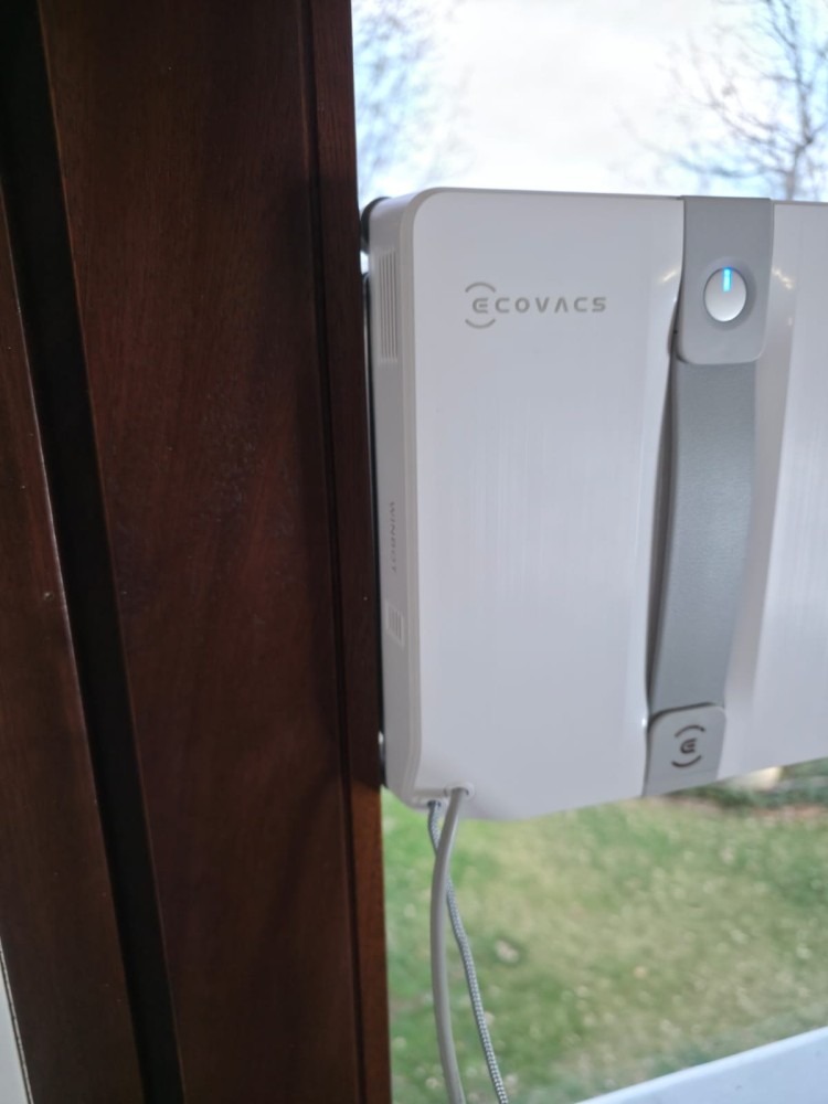

During use, the WINBOT MINI proves to be reliable, stable, and easy to use. Cleaning is fast and effective, with a speed of about 3 minutes per square meter in quick mode.
Windows are generally clean, with very few streaks and only slight moisture residues at the stopping point. Edge cleaning is good, though not perfect. The usefulness of the Winbot Mini is undeniable, especially on external surfaces that are difficult to reach, as it manages to remove dust, rain marks, and superficial dirt.
Noise level is around 63 dB, never annoying. The tank allows coverage of about 20 m² per refill.
