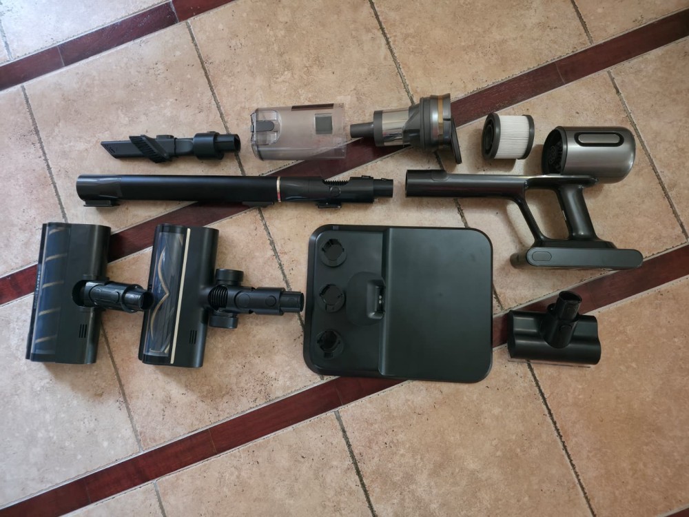

- Accessories: Multi-surface brush, soft brush for floors, flexible and extendable suction tube, motorized mini brush (not included in the Pro-A version), 2-in-1 crevice tool
Design and ergonomics: the comfort that changes everyday use

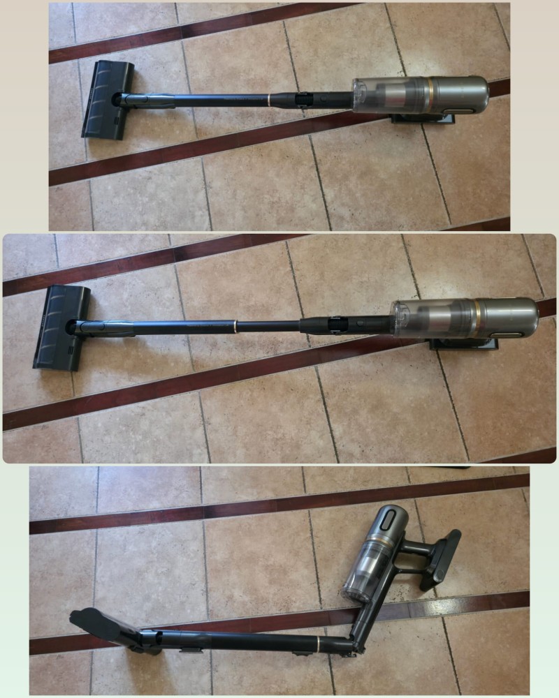

Right from the unboxing, the V20 Pro-A gives the feeling of a premium product. The plastics are solid, the joints are precise, and the assembly is well finished. The flexible central tube that bends to 90°, extendable in four levels, is one of the most successful elements: it lets you easily reach low spaces like under beds and sofas without bending down, and adapt to different heights, improving comfort during everyday use. It’s a solution that, once you try it, truly changes the way you use the vacuum and makes it natural to clean areas that are often neglected purely because they’re inconvenient. The handle is ergonomic and comfortable, even if the choice to place power and mode change on identical upper buttons requires a bit of getting used to; I sometimes found myself confusing the two buttons, and pressing them is a bit awkward with one hand. Since the mode you’ll use practically all the time, because it works wonderfully, is the automatic one, a power on/off trigger would have been more spot-on. The weight, while not low in absolute terms, is very well balanced, with the motor near the handle and the battery balancing the weight: the stick doesn’t “pull” downward and is easy to guide even for long sessions without getting tired.

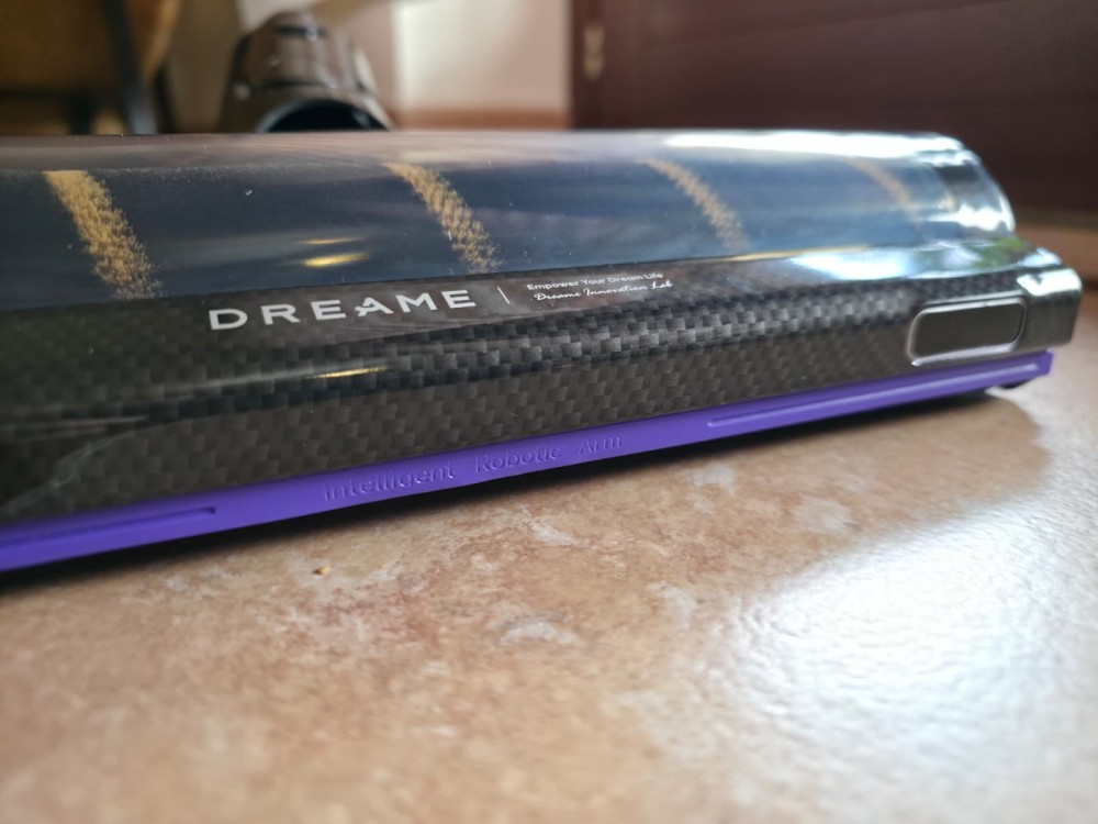

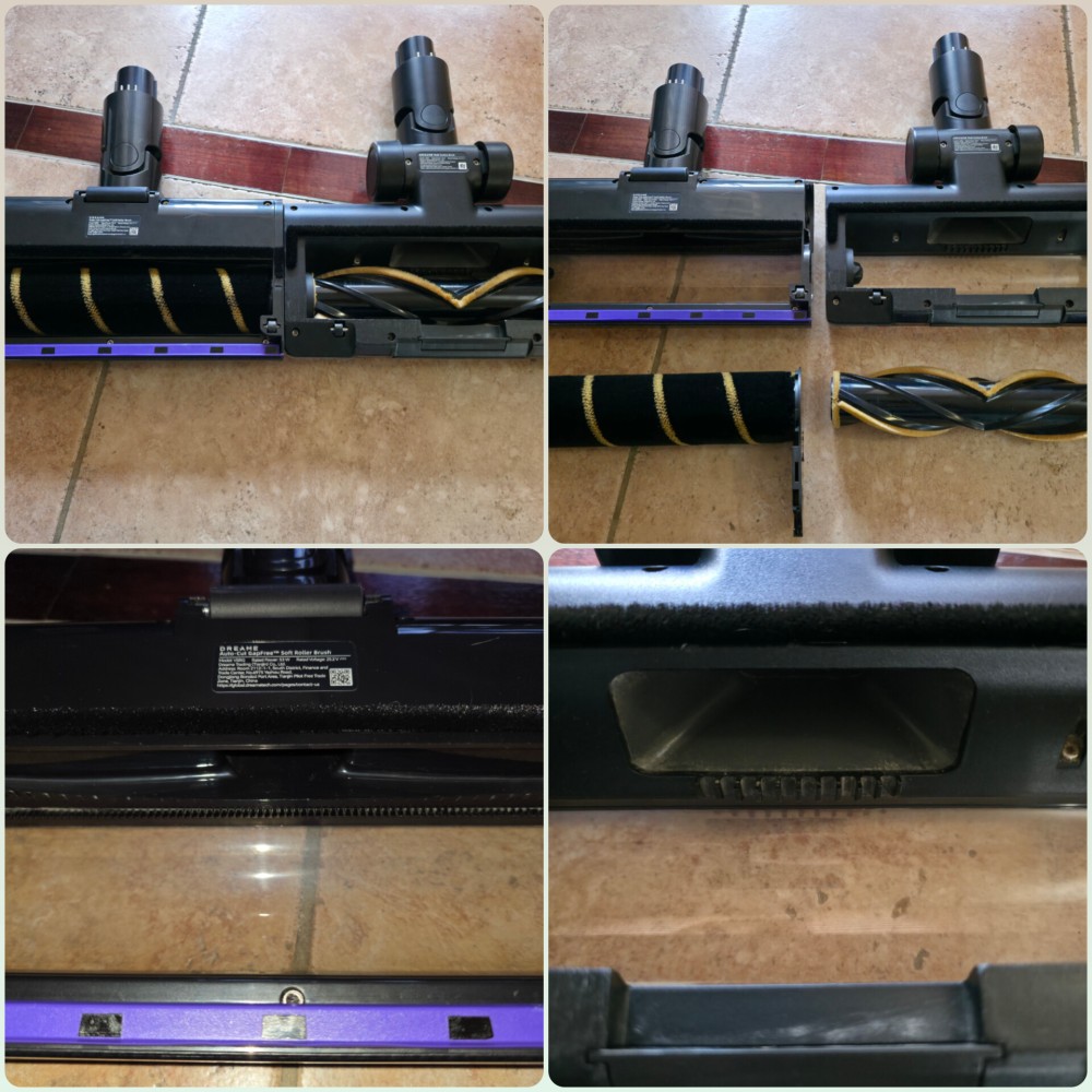

The two brush heads: a multi-approach, not one solution for everything
Dreame makes a very rational choice: two main brush heads, two different behaviors, designed for different surfaces.
Brush with GapFree™ and TangleCut™ (hard floors)
This is the most technologically advanced brush and it’s what makes the V20 Pro unique. Inside the tech: GapFree™ – 0 mm edge cleaning The GapFree™ system uses a front infrared sensor that detects the wall. Only when needed, a flexible front squeegee drops mechanically to seal the gap between floor and wall. In this way: dirt isn’t pushed into the corner but guided toward the brush, the airflow becomes more concentrated, increasing suction pressure in the front area for more effective dirt removal. It is, without exaggeration, the best edge-cleaning system I’ve ever seen on a cordless — precise, effective and smart, because it activates only where it’s needed and when it’s not needed the system remains inactive, keeping the head fluid and smooth-gliding
Inside the tech: TangleCut™ – active anti-tangle
We’re not talking about simple combs here. TangleCut™ uses motorized teeth and scrapers that cut hair and pet fur during roller rotation. The result is fewer hairs wrapped around, less manual maintenance, and a roller that stays cleaner and more efficient over time. You can see the result in the bin too: instead of long tangled spirals, you get shorter fragments, far less likely to jam the roller or require frequent manual intervention. There’s a slight extra noise, similar to an electric razor, but it’s a more than acceptable trade-off for the effectiveness achieved. CelesTect™ lighting on this brush: the light is effective but with a narrower and more angled beam, being positioned low and to the side probably to leave space for the mechanical arm.
Multi-surface brush ( specialized for carpets and rugs)
The second brush doesn’t include GapFree or TangleCut, but uses a different roller design, better suited to textile surfaces like carpets. On carpets and rugs it feels smoother, offers less resistance, and pulls dirt from the fibers better, “combing” them thanks to its design. Here the front light has a wider and more usable angle, often making dirt more readable during cleaning.

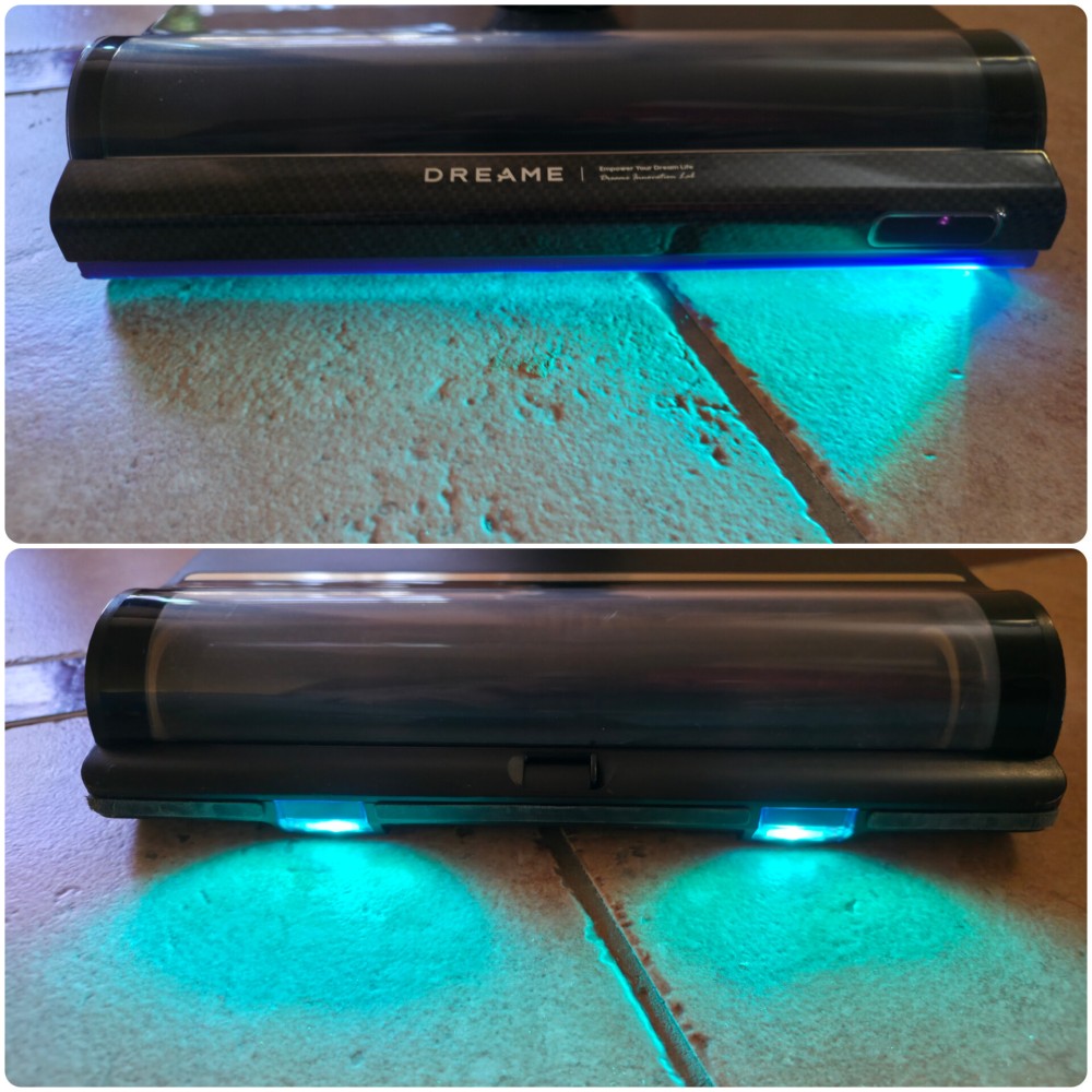

Inside the tech: CelesTect™: seeing dirt changes the result
CelesTect™ technology makes dust up to 16 times more visible. The principle behind CelesTect™ is grazing light. Instead of illuminating the floor from above in a diffused way, the light is projected at a very low angle, almost parallel to the surface. Color temperature and light spectrum are designed to emphasize differences between dirt and the surface. This means every dust particle, even the finest, creates a tiny shadow or a micro visual relief. It’s the same effect you notice when the sun is low at dawn or dusk. On top of that is beam management. It’s not a generic “flood” of light, but a controlled blade that increases contrast between floor and dirt. The result is that dust no longer blends into the color or texture of the floor, but stands out with much greater clarity. On floors that look clean it can feel “ruthless”, but it leads to objectively more accurate cleaning. It’s one of those elements that improves awareness of what you’re actually cleaning.

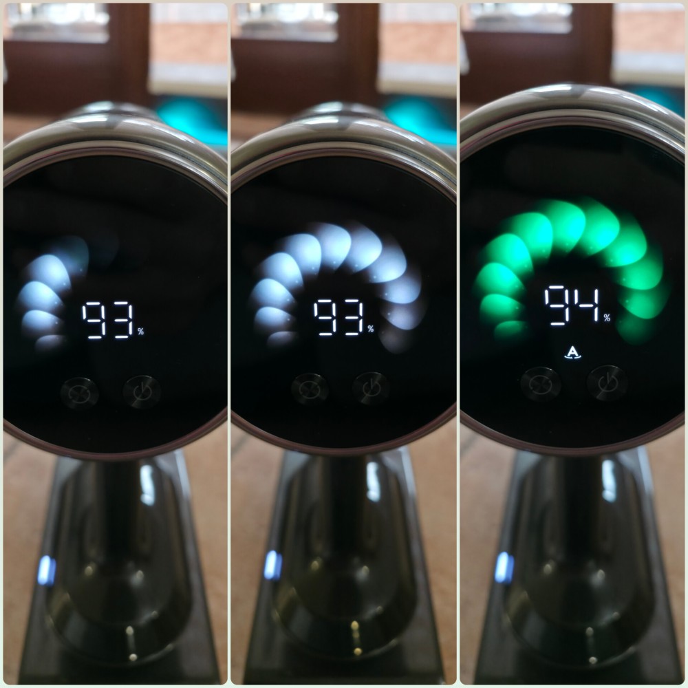

Inside the tech: Smart Dust Detection: automatic mode as it should be
One of the things that impressed me most about the Dreame V20 Pro isn’t just the claimed maximum power, but the way that power is managed. Smart Dust Detection is, in my opinion, one of the best automatic suction regulation systems I’ve tried in recent years. The system is based on an internal sensor that analyzes the airflow being sucked in. Generally, and everything suggests the principle is similar here, it’s an optical sensor: a small light source illuminates the airflow inside the duct and a receiver detects the amount and density of particles passing through it. When the flow contains more dust, more crumbs, or larger particles, the signal changes and the system “understands” that it’s entering a dirtier area. But the interesting part isn’t only the detection. It’s how it reacts. Many automatic systems are slow and almost binary: either they go low, or they go max. Here instead the behavior is progressive, extremely sensitive and above all immediate. You just encounter a bit more hair or a spot with slightly more crumbs than average and you immediately feel a slight increase in power. But it’s not a violent jump: it’s a gradual increase, proportional to the real amount of dirt. And that completely changes the user experience because it means you don’t waste energy where the floor is already clean, you don’t stay underpowered when more suction is needed, and above all you’re not forced to manually change modes.
The circular display helps you “read” what’s happening, showing the detected dirt level with color variations (green → orange → red), but after a few days you stop looking at it. Because you trust it.
And that’s exactly what happened to me: Auto mode has become practically the only mode I use. Yes, you can select Eco or Boost via the button, but in reality there’s hardly any need. Auto mode is so sensitive and efficient that it does exactly what I would do… just faster and more efficiently.
Another key aspect is the impact on runtime. Always using maximum power means draining the battery quickly. Here instead the system increases power only where it’s needed and only for the time required. This not only improves cleaning quality in critical areas, but also lets you make better use of the available charge.

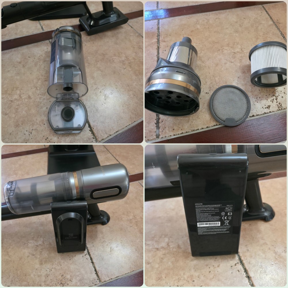

Filtration and maintenance: designed to last over time
The Dreame V20 Pro-A adopts a 5-stage filtration system. According to the stated data, it can capture 99.99% of particles down to 0.1 μm, including fine dust, pollen and allergens. So it’s not only about floor cleaning, but also about the quality of the air returned to the room. Filtration works on multiple levels. The 12 cyclones carry out a first separation of larger particles, helping keep suction power stable even when the bin begins to fill. Then pre-filters and a final HEPA-type filter trap finer particles before air is released back into the room. This multi-level system protects the motor over time and reduces the dispersion of allergens into the air, making the V20 Pro-A suitable even for those who are more sensitive to dust. The dust bin has a 0.5-liter capacity. It’s a fairly common size in the compact cordless category, but it should be interpreted correctly. For regular maintenance and frequent cleaning it’s more than adequate. However, during more intense cleaning with lots of pet hair, it can fill up quite quickly. Hair, in fact, takes up a lot of volume and saturates the bin faster than fine dust alone. In these cases it may be necessary to empty it more often, even during a single particularly demanding cleaning session. Emptying is still simple: the bin detaches from the motor body without having to carry the whole vacuum with you, and the lower flap opening allows you to release the contents in a relatively clean way. Filters, bin and rollers are removable and washable without tools. Just rinse under running water and let them dry completely (ideally at least 24 hours) before reassembling. The TangleCut™ system also effectively reduces hair buildup around the roller, decreasing how often you need to intervene manually. Overall, filtration and maintenance are handled in a way that’s consistent with the product’s philosophy: no complicated solutions, but an effective, washable system designed to keep performance high over time without turning cleaning into an ongoing maintenance operation.

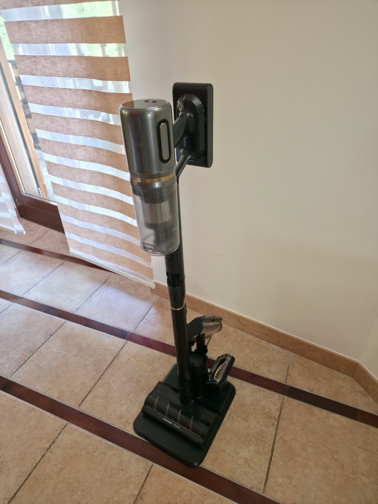

Charging base with weighted stand
A detail that may seem secondary, but in reality has a huge impact on everyday experience, is the floor charging base. We’re not talking about the classic lightweight plastic support. Here we have a weighted stand, with a significant mass that lets it stay firmly planted on the floor. It doesn’t wobble when you insert or remove the vacuum, and it never feels unstable. It lets the vacuum stand upright without drilling holes in the wall. It’s super convenient for “grab & go” use. Then, and here we inevitably enter the realm of personal taste, some people prefer to hang the vacuum on the wall to optimize every centimeter of space. And that’s understandable. But there are also people, and I definitely put myself in this category, who hate drilling into the wall to install a fixed stand. Between holes, wall plugs, a final position and structural constraints, a wall solution isn’t always the most practical or desirable. In this sense, the V20 Pro’s base is a smart solution: once you put it back, the stick automatically recharges via the integrated contacts; you take it, use it, put it back, and it goes back on charge. The whole setup stays tidy and relatively compact, even though it inevitably takes up more space than a wall hook.
