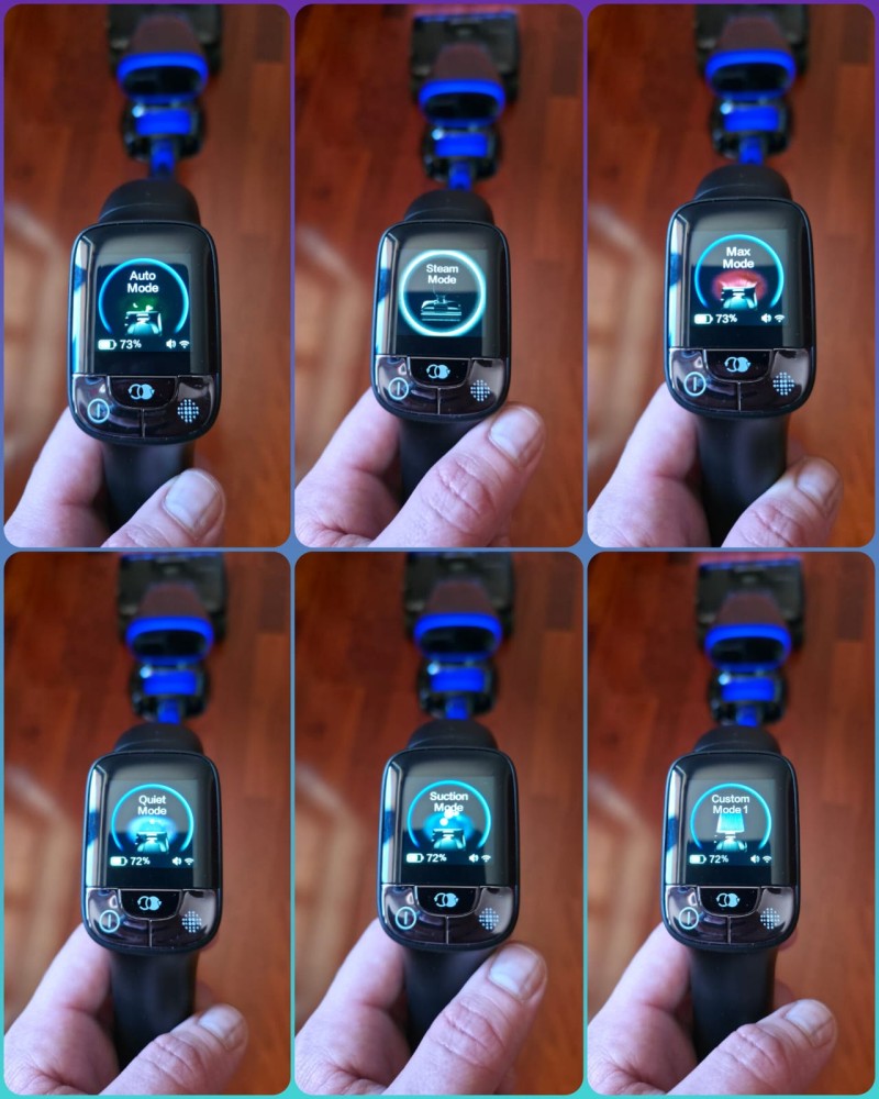

The smart experience is what distinguishes the S9: app connection, firmware updates, customizable modes, two additional configurable profiles and traction adjustment. The IMD 3D display and dynamic lighting complete a modern and more refined interface compared to its smaller sibling.

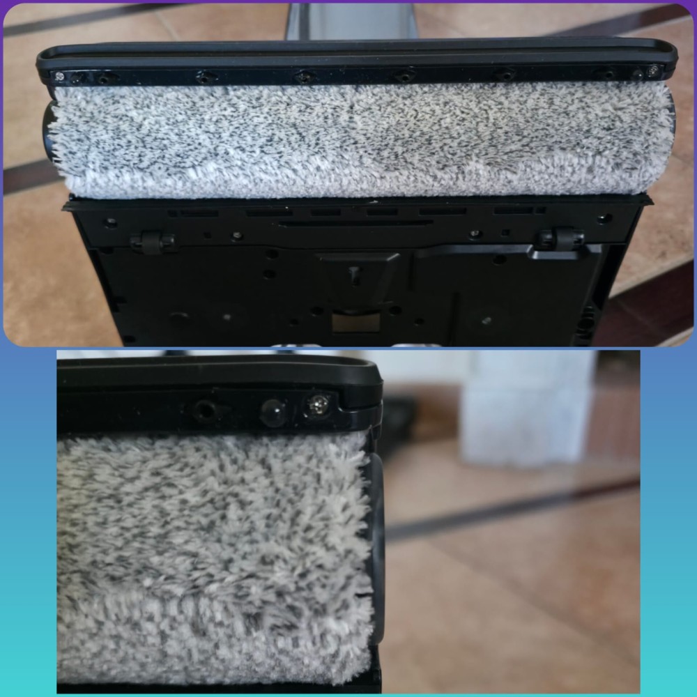

Inside ReverseScrub technology with 720° rotation
When we read “720° rotation” in the specifications, the risk is to file it away as a brochure number. In reality, it is one of the most interesting elements of the technical platform of S7 Stretch Steam and S9 Artist Steam Pro.
The roller does not simply rotate forward as happens in systems of other floor washers. It works bidirectionally, alternating forward and backward rotation. The reference to 720 degrees indicates that, in one cycle, the surface of the roller completes two full rotations, one in each direction.
This has a very concrete effect on cleaning because each portion of microfiber comes into contact with the floor multiple times and at different angles. The result is not just a “double pass”, but greater mechanical action on dirt. When the roller spins forward it helps distribute clean water and begin loosening dirt. When it reverses, it performs a second scrubbing action.
This alternating movement especially improves management of dry dirt and grease traces in the kitchen. From a mechanical point of view, the advantage also lies in wear distribution. The fiber does not always work in the same direction and on the same point, but alternates load. This helps maintain more consistent performance over time.
Combined with the MHCBS continuous washing system, which constantly rinses the roller with clean water, combs it and cleans it, bidirectional rotation helps avoid multiple passes, typical of less advanced systems.
In daily practice this translates into less need to go over the same area multiple times. Especially in Steam mode, where steam softens dirt, the forward-backward roller movement increases mechanical detachment efficiency, making the pass more incisive without requiring greater effort from the user.
It is a technical detail that does not change practical use of the machine, but changes the way it works on the floor. And in products like S7 Stretch Steam and S9 Artist Steam Pro, which share this platform, it is one of the elements that contributes to the feeling of more uniform and “deeper” cleaning.

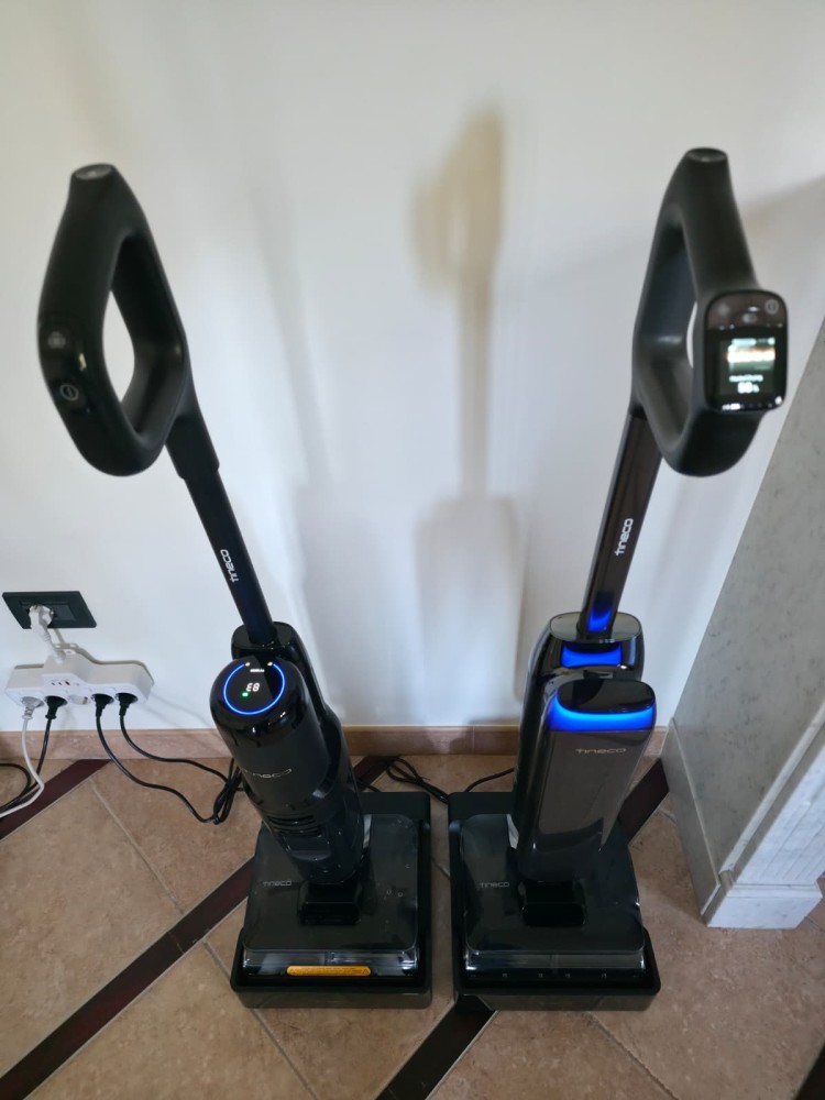

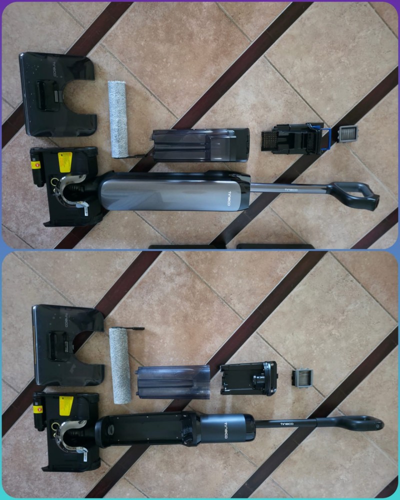

Technical differences

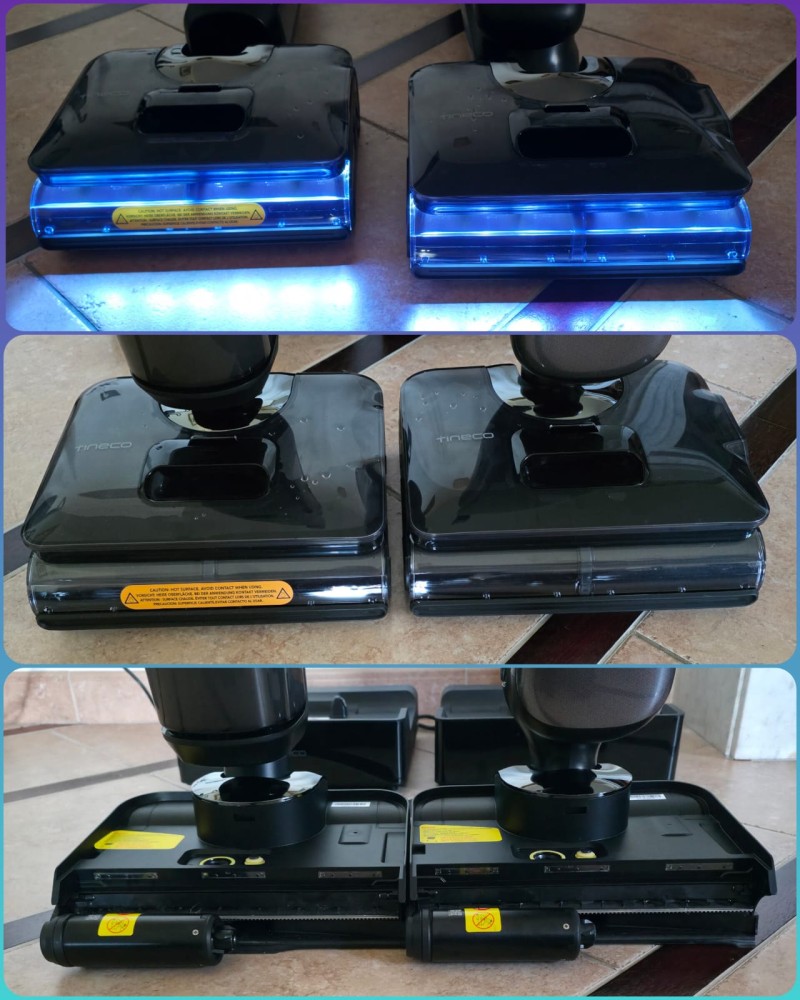

The two machines share:
22,000 Pa suction
HyperSteam steam at 160 °C
720° ReverseScrub roller rotation
DualBlock anti-tangle system
FlashDry self-cleaning with drying at 85 °C
Steam mode with approximately 30 minutes of battery life
Main differences focus on:
Slightly larger dirty water tank capacity on the S9
App connection, present only on S9
Customizable modes and firmware updates, exclusive to S9
Wheel traction adjustment, present on S9
Overall weight, lower on the S7
Design and interface, more refined on the S9

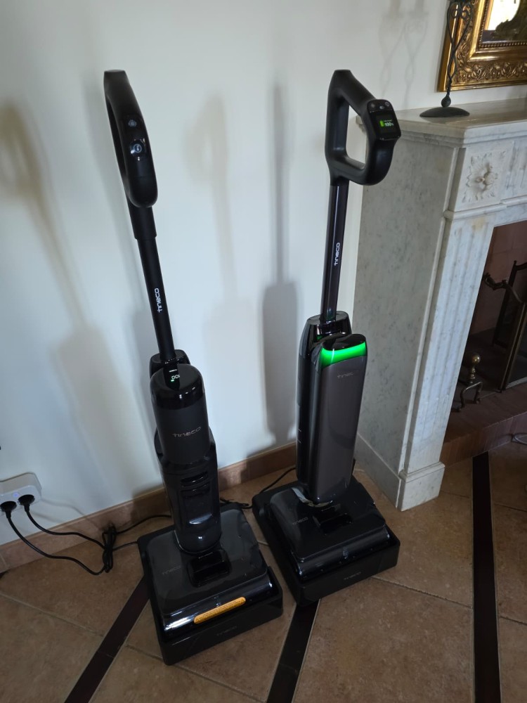

The Tineco FLOOR ONE S9 Artist Steam Pro and the Tineco FLOOR ONE S7 Stretch Steam share a very similar technical platform. From a purely cleaning standpoint, they are extremely close. Steam mode battery life, about 30 minutes, is also aligned.
The real difference is not so much in the result on the floor as in positioning, experience and price.
The S7 Stretch Steam has a list price of 699 euros. It is lighter, more immediate, does not require configurations, does not connect to the app and does not provide firmware updates. It is a concrete, powerful and rational machine. It offers practically the same effectiveness as the S9 but with a simpler and more direct approach. It is the ideal choice for those who want advanced technology without entering the world of smart customization and without facing the cost of the top version.
The S9 Artist Steam Pro has a list price of 849 euros. Here the extra cost is not justified so much by superior power, but by a superior experience. App connection, configurable modes, firmware updates, traction adjustment, larger tanks and a more evolved interface. But above all, design.
The S9 is clearly designed with greater aesthetic attention. The finishes, the IMD 3D display, the dynamic Aurora AI lights and the overall lines make it not only a cleaning tool, but also an object to display as a furnishing element. Those looking for a product that is not only functional but also visually refined will find something more in the S9. It is a machine that, even when charging on its base, communicates a certain level of refinement.
