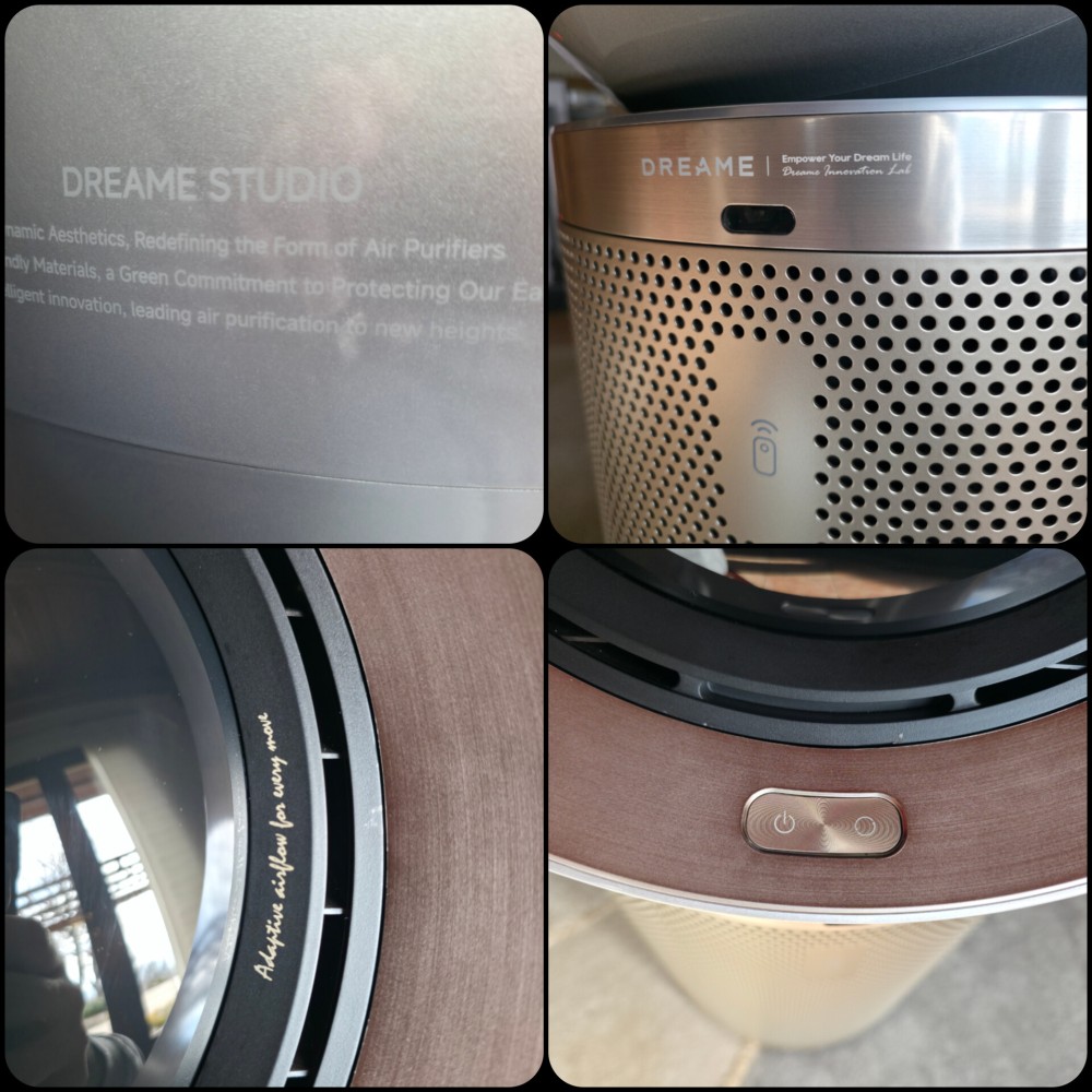

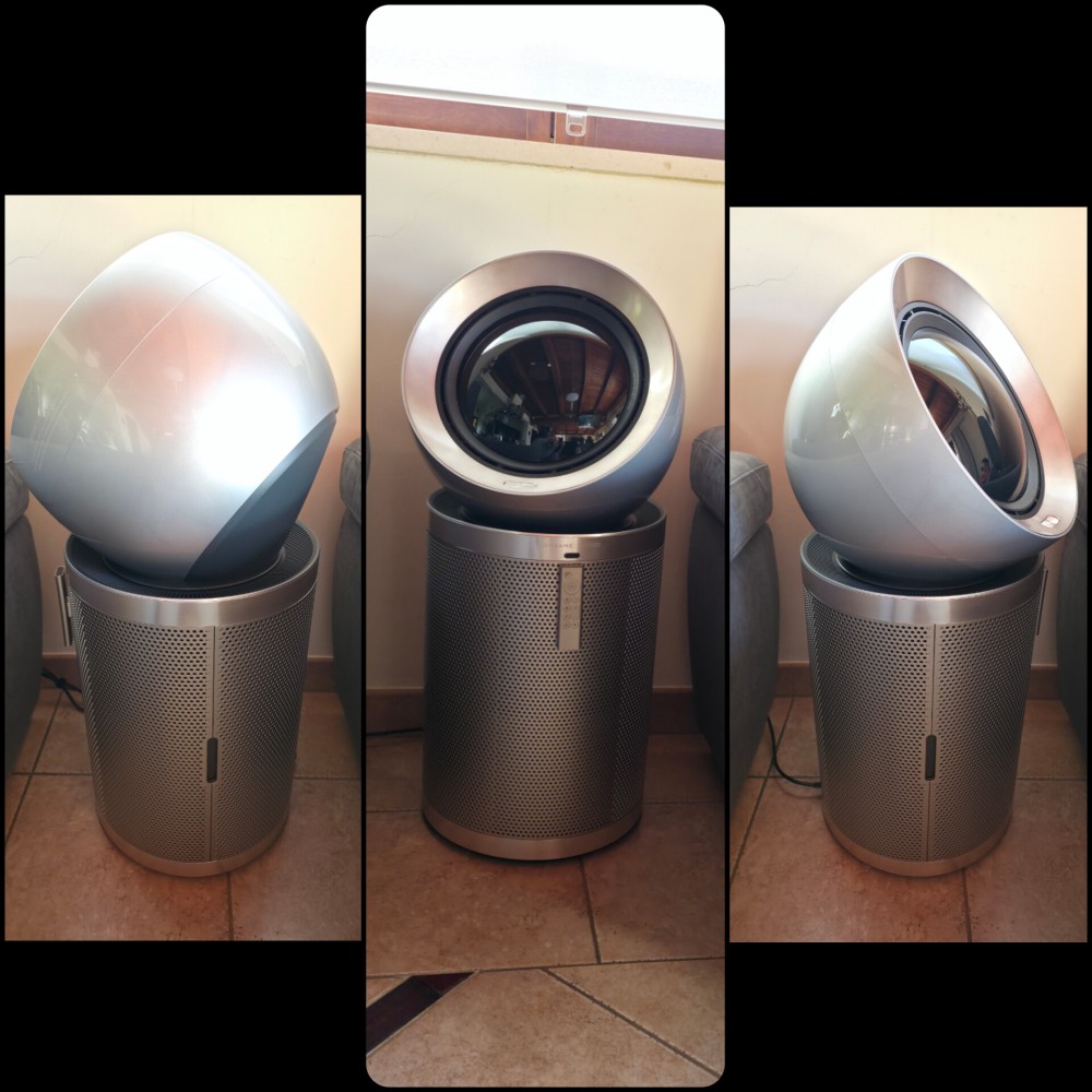

The Dreame PM20 AirPursue is a substantial device in both size and visual presence. Standing at approximately 85 cm tall, with a cylindrical structure and a rotatable upper head, it is not designed to be hidden, but to be displayed, provided of course that the design appeals to you.There is no denying that, aesthetically, the PM20 takes inspiration from the formal language of high-end Dyson purifiers: rounded head, cylindrical body. However, reducing the project to a simple stylistic resemblance would be superficial.Behind this design choice there is not only an aesthetic reference, but a precise technical logic. The separation between body and head allows:more controlled airflow distributionindependent management of airflow direction up to 180°integration of the Enviro Detect radar systembetter modulation between suction and projectionThe overall construction gives a premium feel: high-quality materials, well-assembled components, smooth panels, understated finishes without sharp edges, with controls and displays positioned intuitively.The upper head integrates the LCD display that shows air quality, detected pollutants, operating modes, temperature, humidity and filter status, useful and well integrated into the large central “eye”, although slightly small compared to the wide available space. The base features integrated wheels, an essential detail considering its size and 12.7 kg weight: moving it between rooms is easy and does not require lifting it, although you’ll need some muscle if you want to move it to another floor.

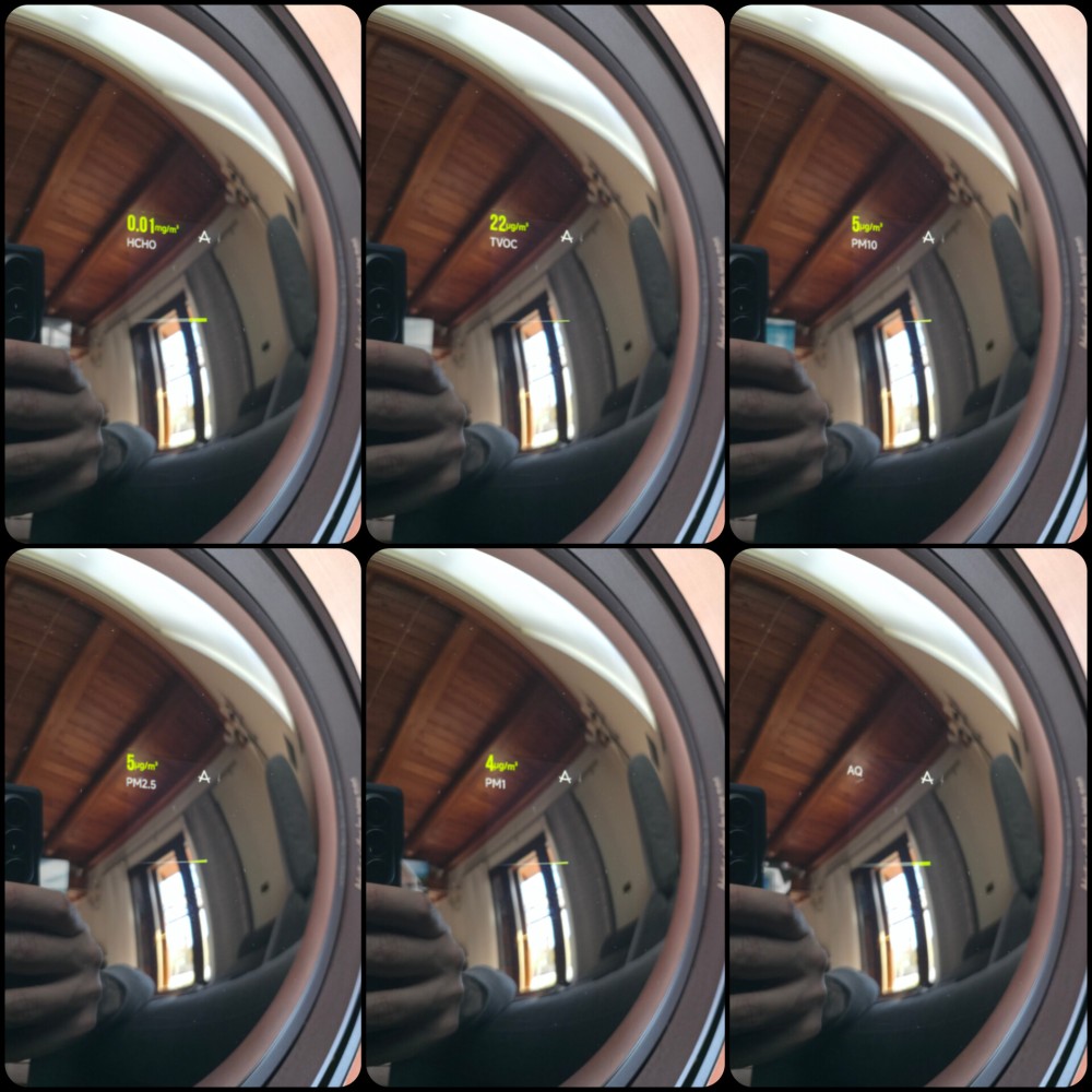

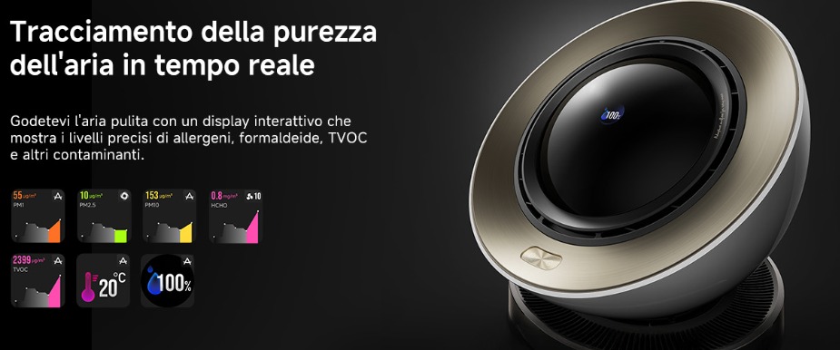

One of the most interesting aspects is its ability to detect, thanks to its 7D sensors, up to 14 environmental parameters, including:
- PM1What it is: particles with diameter ≤ 1 micron, among the most dangerous because they penetrate deep into the lungs and can enter the bloodstream, typically combustion residues such as cigarette smoke and candles, smog, cooking fumes, viruses.
- PM2.5What it is: particles with diameter ≤ 2.5 microns, the most commonly used parameter in air quality indexes (AQI), typically fine traffic dust, allergens, molds, bacteria.
- PM10What it is: particles ≤ 10 microns, including visible dust, fine sand, pollen, larger particles.
- HCHO (Formaldehyde)
- TVOC (Total Volatile Organic Compounds)What it is: does not indicate a specific substance but an overall concentration of volatile chemical and organic substances, including formaldehyde, solvents, ammonia, benzene, emissions from glues and paints.
- temperature
- humidity

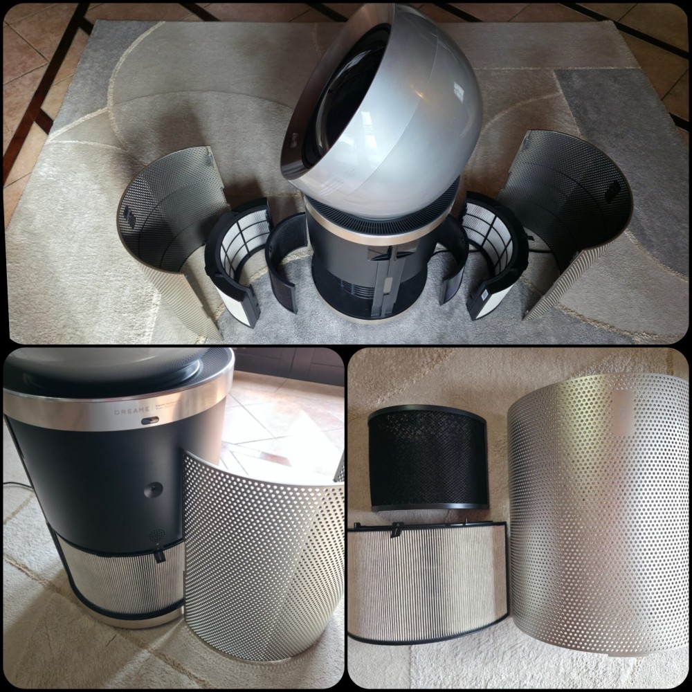

The heart of an air purifier is its filtration system, and in this respect the Dreame PM20 performs very well.It integrates a multi-stage filtration system consisting of:
Magnetic pre-filter: captures larger particles such as dust, hair and fibers.
HEPA H13 filter: capable of intercepting ultrafine particles, including:
PM1
PM2.5
PM10
Activated carbon filter: specific for:
irritating
gaseskitchen and pet odors
TVOC4.
“Formaldehyde-Cata” filter integrated into the activated carbon filter.
The Formaldehyde-Cata filter is a specialized catalytic layer that does not merely trap formaldehyde, which is a carcinogenic gas, but decomposes it into water (H₂O) and carbon dioxide (CO₂) through a catalyst (MnO₂) present in the filtering material. This process differs from traditional carbon filters that only absorb gases: here formaldehyde is converted into safer compounds, reducing accumulation inside the filter and lowering replacement frequency.
Plasma and IonizationThe system generates high-energy ions and cold plasma that are released into the airflow. They destabilize bacterial and viral cell membranes, oxidize volatile organic compounds and help neutralize odors.
UVC – Ultraviolet sanitizationUVC is ultraviolet radiation at a germicidal wavelength, it damages the DNA and RNA of viruses and bacteria, prevents microorganism replication and reduces biological load in the airflow
The system is designed for differentiated replacement:
- activated carbon/Cata filter: every 6–12 months
- HEPA filter: every 16–24 months
This combination allows the Dreame PM20 to handle fine particles, viruses and bacteria, gases and persistent odors, offering a complete purification experience.

During my test in an open space environment of about 60 m², and after an intense cooking session, the device showed:
- Almost immediate sensor activation and detection of pollutant peak
- Return to “Excellent” air quality in about 10 minutes
This is not a laboratory test, but it represents a realistic scenario.

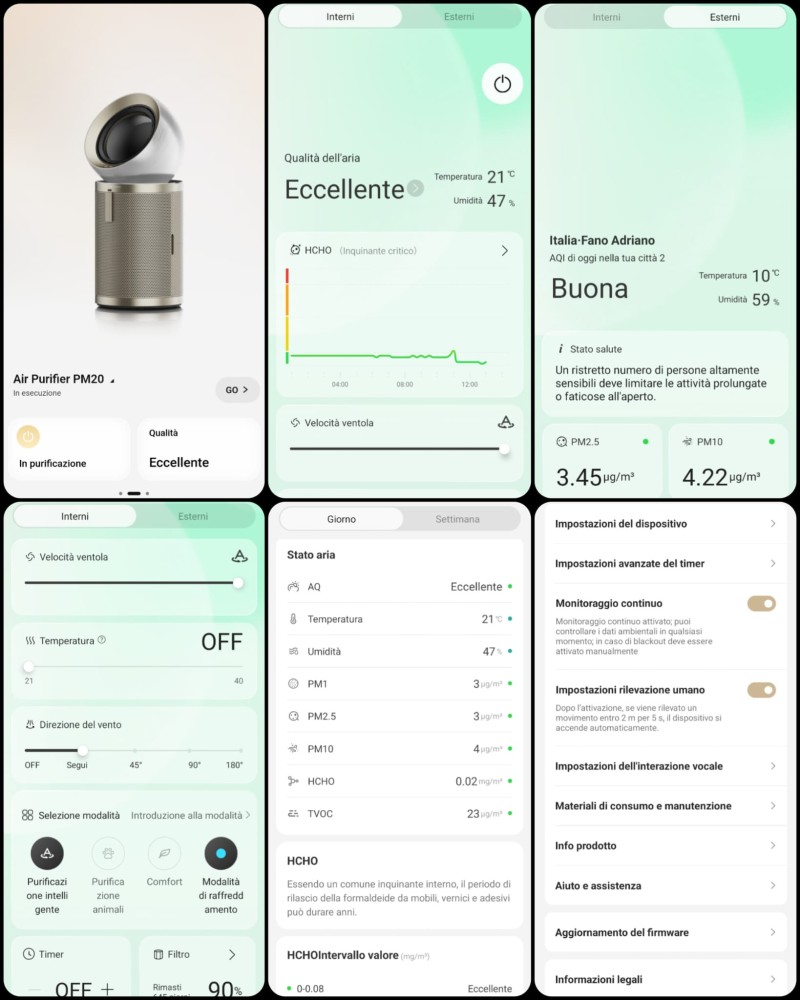

The app provides historical data and qualitative classifications (“excellent”, “good”, “moderate”, “poor”), making interpretation accessible even to those unfamiliar with technical parameters.

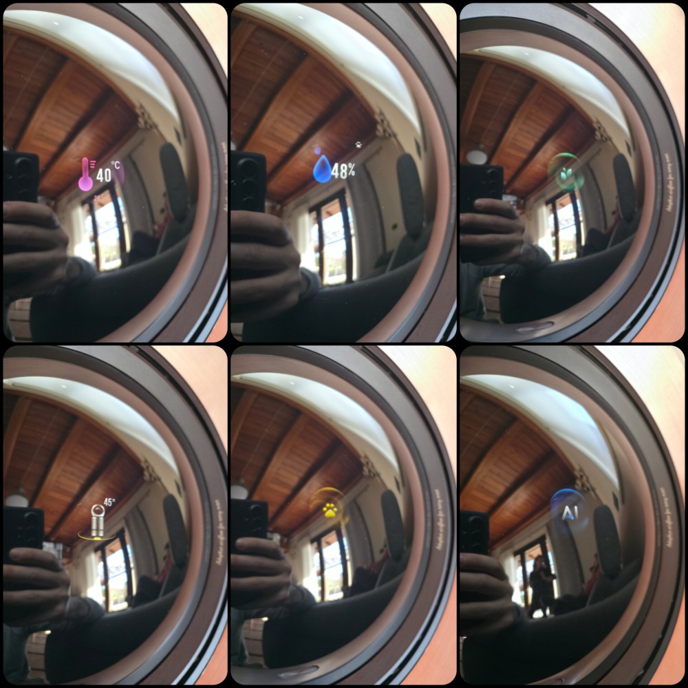

Operating modes
The Dreame AirPursue PM20 is not just a purifier. It also integrates:
Manual ventilation: Allows manual selection of fan speed and airflow angle at 45°/90°/180°.
Heating: Heats the air while filtering it. Ideal in winter or for direct comfort. It integrates a ceramic PTC module (Positive Temperature Coefficient), a self-regulating technology that increases temperature rapidly and stabilizes heat without spikes, with more stable temperature control and greater energy efficiency, adjustable up to 40° and taking about 3 seconds to reach the set temperature.
AI Follow: For dynamic airflow that follows users.
Pet Purify: Maximizes airflow and creates greater negative pressure in the surrounding area, working more reactively on suspended hair and odors, noise remains around 60 dB.
Comfort: Fans at minimum and screen off, in this mode operation is super quiet, almost imperceptible around 32 dB.

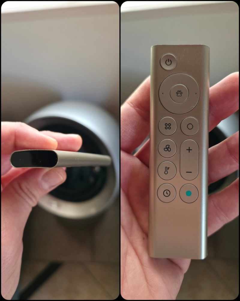

The PM20 can be controlled via:
- physical buttons
- remote control (magnetically attachable to the base)
- DreameHome app
The app is a true control center: it displays real-time data, pollutant history, filter status and allows full mode management, daily and weekly scheduling.
For those who like to monitor their home environment analytically, it is one of the most informative purifiers in its category.
